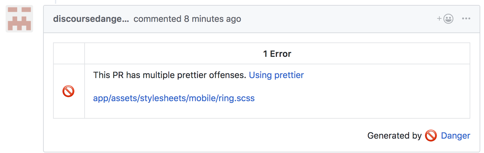

When creating a pull request to our main Discourse repository, you might have noticed a bot sending this message in the comments:
We have been using Prettier on our codebase for a few weeks now, and are enforcing it in pull request too now.
