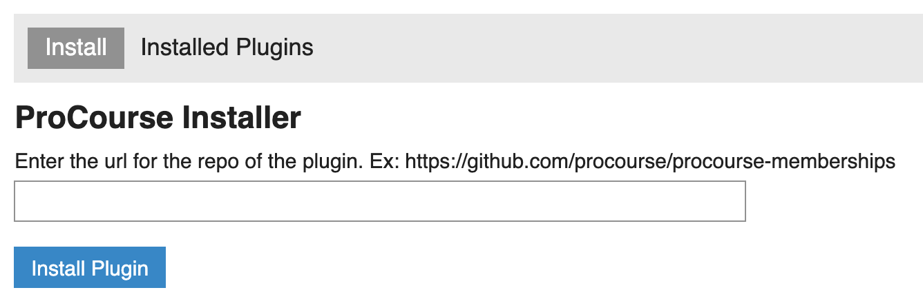

This plugin is designed to make it extremely easy to install new plugins without logging into the server. It adds a screen under /admin/plugins/procourse-installer that looks like this:
From there, you can enter the URL (with or without .git) of the plugin git repo and click Install Plugin. Wait a few minutes (about 5 minutes) for the installation to complete and you’re good to go.
To see all the plugins you’ve installed through the installer or to remove a plugin, just go to Installed Plugins.
