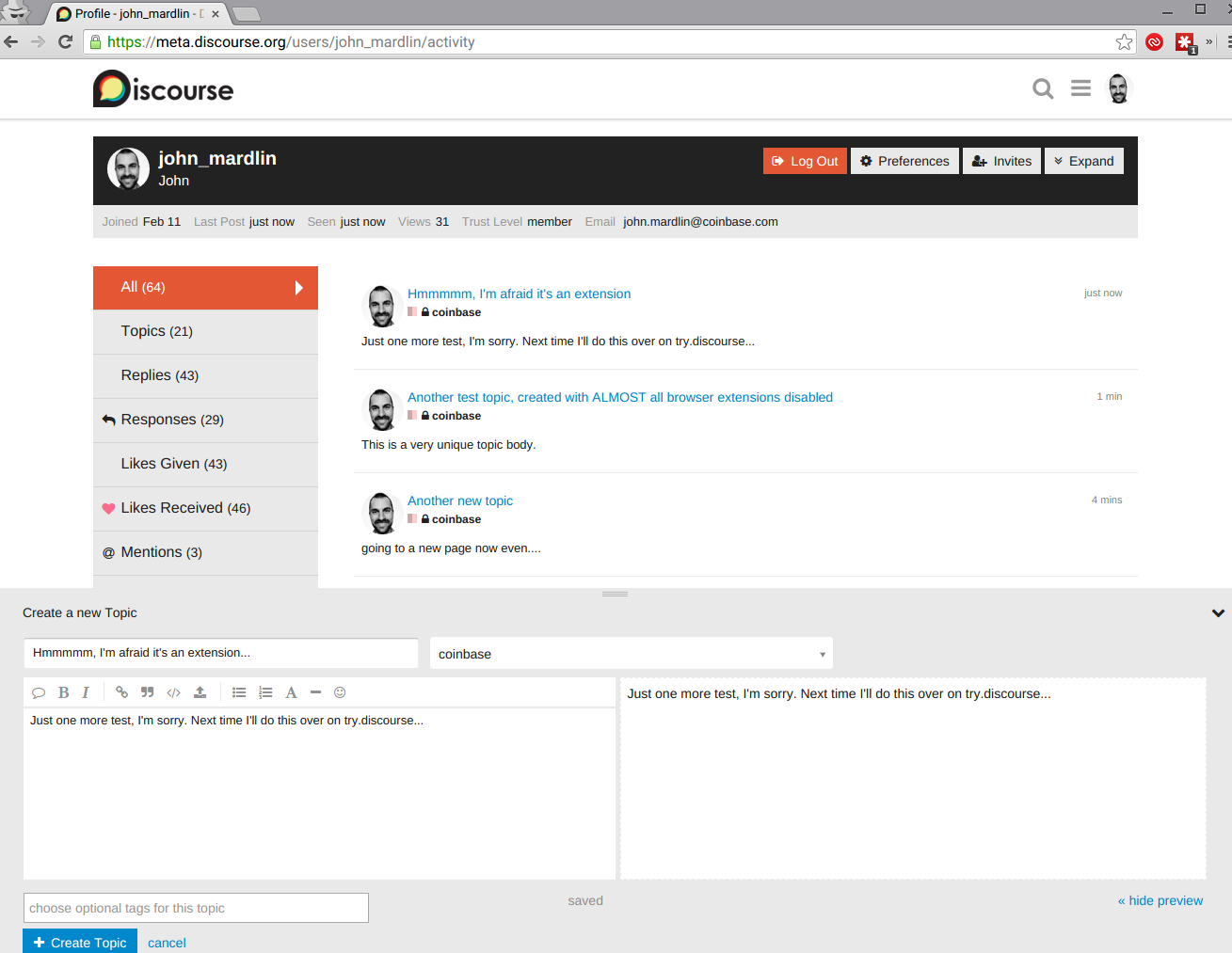

Repro’d here (I though I was recording with my microphone muted, so you can mute the video without missing anything):
After the video finished, I went to an incognito window and logged into Discourse to test without chrome extensions that might be causing trouble.
Here’s what happened in that new incognito session:
  • The very first topic I published in that session did not have the issue.
  • So thinking I had determined that it was an extension, I created another topic. Unfortunately, the bug cropped up again. Note that the create a new topic contents are identical to the latest post in my activity feed;
