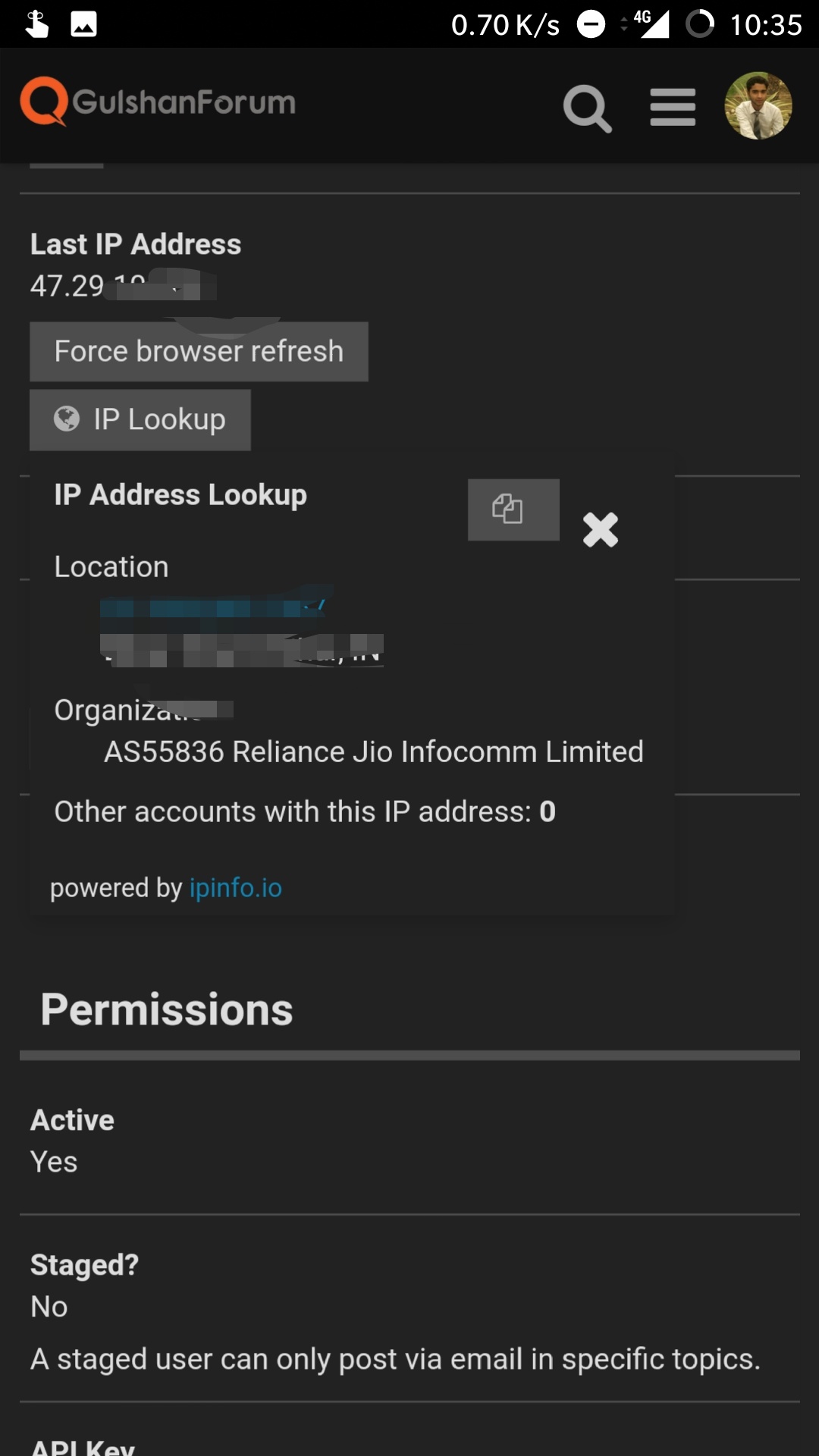

In my case,
PC is IPV4 only
Mob is IPV4 + IPV6 supported.
I noticed, Discourse shows 127.0.0.1 IP.
(Ref: screenshot taken from mob, while using IPV6 network.)
Note:
  • Apart from A Record, I have one AAAA DNS records also.
  • I have simple installation as recommended. Nothing special.
What should I do?
Thanks
