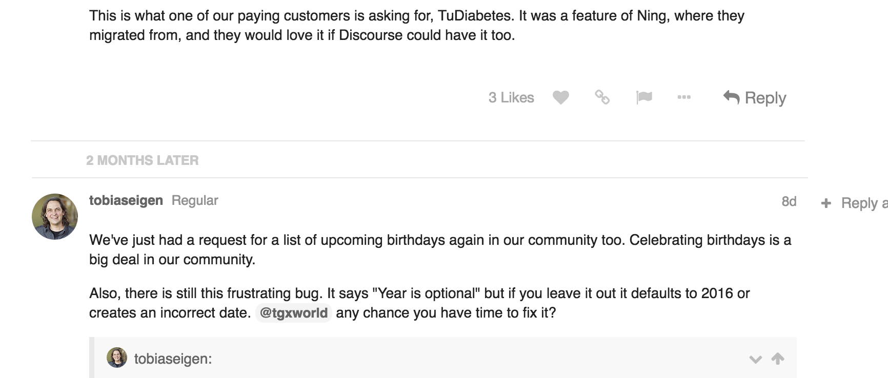

Going to add my two cents here: I don’t like the new design. Not sure if it is the missing bottom line, or the lack of the clock, but it seems to blend in too much for me. I like the double line and clock icon because it was very visual, and easy to see that time had elapsed. Now it is harder to see quickly…
3 „Gefällt mir“
I agree, not a fan of this change, the double line was signifying a break in continuity, it was far more visually obvious. The way it looks now to me is a bit of a visual bug…

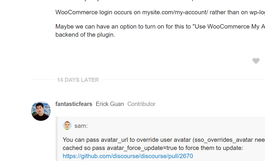

Either:
or
Work better for me, cause at least that word is not floating in an unclear space.
8 „Gefällt mir“

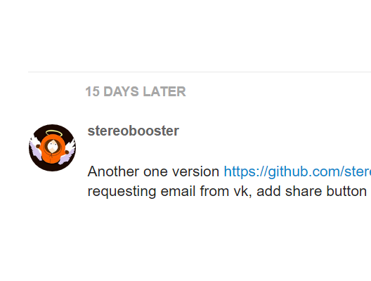

The last one looks really good! I’m all for that one. Actually both work; the first one just looked weird at first because of the cropping.
p.s. the centering was really important because it breaks with the left-align and communicates to a scanning eye that a change happened. My design doesn’t work without it. I like Sam’s iteration more though.
I darkened the text a bit that make the “omit line only” work a bit better.
Placing on the line gives us some extra vertical space, but this iteration at least looks right (imo)
3 „Gefällt mir“
