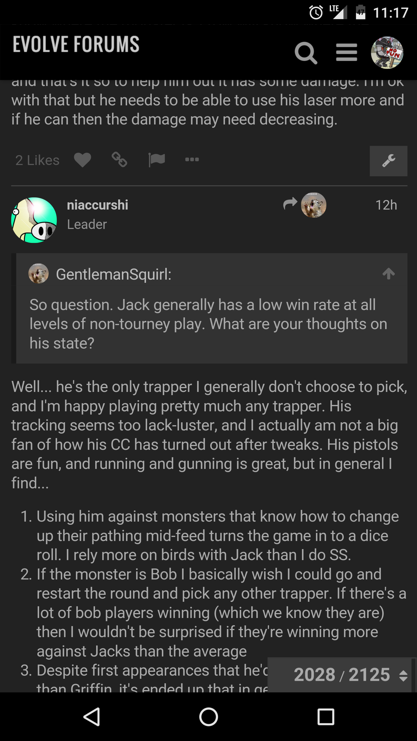

Replies do not link back to original post [Mobile]
This is a strange one. All of the posts linked in the post below are replies, but the reply links at the top of the page (Arrow +avatar) do nothing.
To complicate things more, it seems relegated (so far) to one user.

The user who reported the issue thinks that because he is viewing on mobile and the original topic is decently large that the post he’s trying to link back to hasn’t been loaded by the forum so there’s nothing to link back to.
There was a long standing bug that the link doesn’t work I’d the answer is more than N topics apart and isn’t pre loaded.
