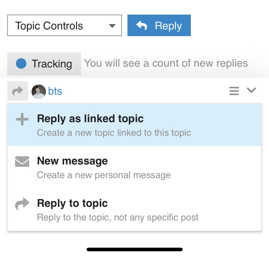

It’s a bit of an odd one though, responding to the topic ‘at large’ implies you have read it. If you really want to reply to the topic you can click the reply button on any post, then change the reply action to ‘Reply to Topic’:

Lol. I have no idea that was possible, because it is that not clear, it seems to be just an arrow in the editor. :face_with_monocle:
Almost. I want it to work as “Reply to the topic, not any specific post” option that’s hide. Let’s see, then I create a topic in #theme-component.
