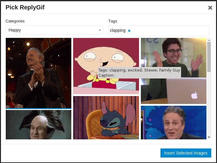

I have rewritten the ReplyGIF plugin by @lightyear so it works with the latest version of Discourse
With this rewrite there were a few changes, all gifs are paused automatically and can be clicked to start the animation and you can select multiple animations to insert into your post (so long as they are part of the same category/tags).

Awesome plugin. Works great on my install. Well… Maybe too great.
Would be cool to have out of the box a limiter. So we can set a limit on how many gifs can be used in one post. So users can’t reply to a thread with 5000 gifs. (which i did in testing lol)
You have to uncheck the other .gif that you have selected before posting.
But I agree with you. The better solution is that @cpradio add an option in admin panel to set a limit per post (and topic too).
Okay, so I’m not against such an idea, but realize there will be limitations that are beyond my control. I can limit how many you select in the Modal (fairly certain), but I since I’m not tying into the composer, I couldn’t stop someone from opening the model twice to get 10 images (when the limit is 5).
The larger issue I think is Discourse currently has no way to limit the number of images beyond TL 1. It may be worthwhile to see that as a feature versus making that specific to this plugin. As one could simply reference 5000 gifs outside of my plugin and still cause the same pain.
@sam, @zogstrip, what do you think of such a feature? If it is something we could have, maybe 0 (off by default), it might be something I look at contributing and it would only apply to TL1 and higher (staff would be exempt).
