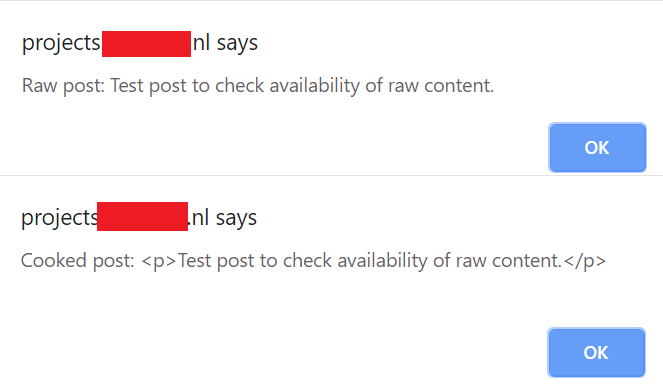

At the moment I am working on an extra PostMenuButton. Funny thing is that the Cooked post is always available but the Raw post is not!

    alert("Raw post: " + post.raw);
    alert("Cooked post: " + post.cooked);

  2. Create a new post, do not refresh, click the calendar icon.
  3. See the alert pop-ups.
  4. Refresh the page. Click on the calendar button again for the same post.
  5. Now the post only has the cooked content available, raw content is not getting through.
