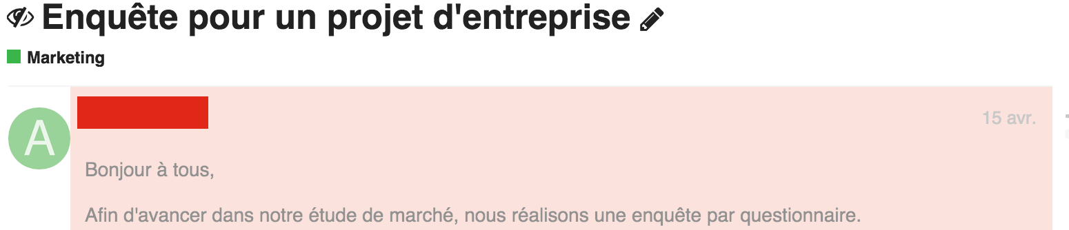

For example this page: https://forum.pragmaticentrepreneurs.com/t/enquete-pour-un-projet-dentreprise/3579 (it returns a 404 currently)
Here is what it looks when you are an admin:
It looks deleted, not just unlisted. That’s why the body content is that pink color – that means deleted.
