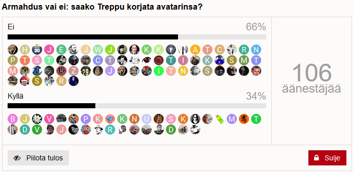

We had a public poll where 106 votes had been cast. There were 69 votes for “no” and 37 for “yes”. A simple division gives that 69/106 is about 65.09 %. Yet the system tells that 66 % had voted for “no” and 34 % for “yes”. Here’s a picture:
The final result was 72 votes for “no” and 38 for “yes” and the poll is now closed. 72/110 is about 65,45 % which the system rounds to 66 % as well, so you can see the bug in action at Tappara.co.

Not sure I understand what’s broken here. The poll will round the % so they add up to 100%.
The outcome is terrible, that’s what is broken. :slight_smile:
