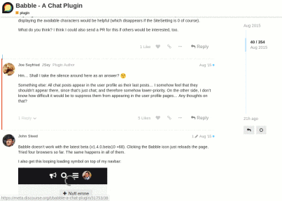

Enter a large topic (> 100 posts is good, but sometimes it happens on smaller topics). Read the topic and use j to move from post to post. Eventually the scrolling just stops. Right before that happens, the red bar to the side of the active post (for the purposes of j) disappears. This GIF shows it, with fast frame rates while it is working, and slow frame rates when it fails:
