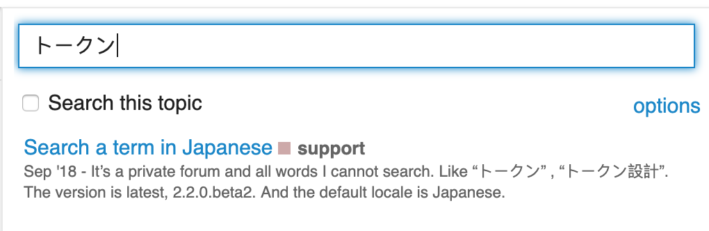

There isn’t anything inherent blocking the search of japanese characters, for example from your post above:
Yes, seems to work here:

Thank you, hmm it doesn’t work in our forum. Let me check.
