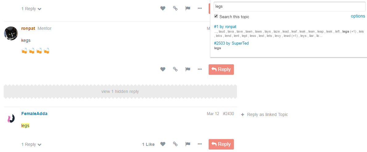

Another oddity, it is highlighting the word, but isn’t showing it in the search result
I even tried searching for that user specifically using user:FemaleAdda and that didn’t find it either.
Another intriguing thing. Searching the forum can return that post as a result
Doing similar searches for ‘trending’ and ‘hashtags’ with user:SmithKelvin11 also returns the posts that “Search this Topic” fails to return.

I have seen it doing that, too, but as you can see from my screen-shots above, it doesn’t always.
Ah, I know how to quantify that a bit. It seems the highlighting is case-sensitive (to a degree). Searching for “Hashtag”, highlights the word in post #3, but fails to highlight the ones further down. Likewise, “hashtag” highlights the ones further down, but fails to highlight “Hashtag” in post #3.
The highlighting seems very temperamental to me though. Just searching for the two words and scrolling up and down produce very inconsistent results. Sometimes zero words are highlighted, other times, 2 of the 3 references (especially when searching “hashtag”), sometimes all 3 references (especially when searching “Hashtag”, but not always).

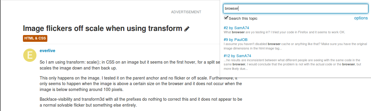

OK - this topic has 15 posts and 0 deleted posts.
Search terms are not appearing for the first post in that topic. For example, “browser”:
As far as I can tell from my testing, if a post does not appear in topic search for one term, it will not appear for any term.
Search for “flicker” in that topic, and it shows just one result, post #13.
But the term also occurs twice in post #1, and again in post #11. (It is, in fact, a quote from post #11 which is shown in the results from post #13.)
Using Firefox’s native Ctrl+F search finds all the instances, as expected.
Hope that helps.
