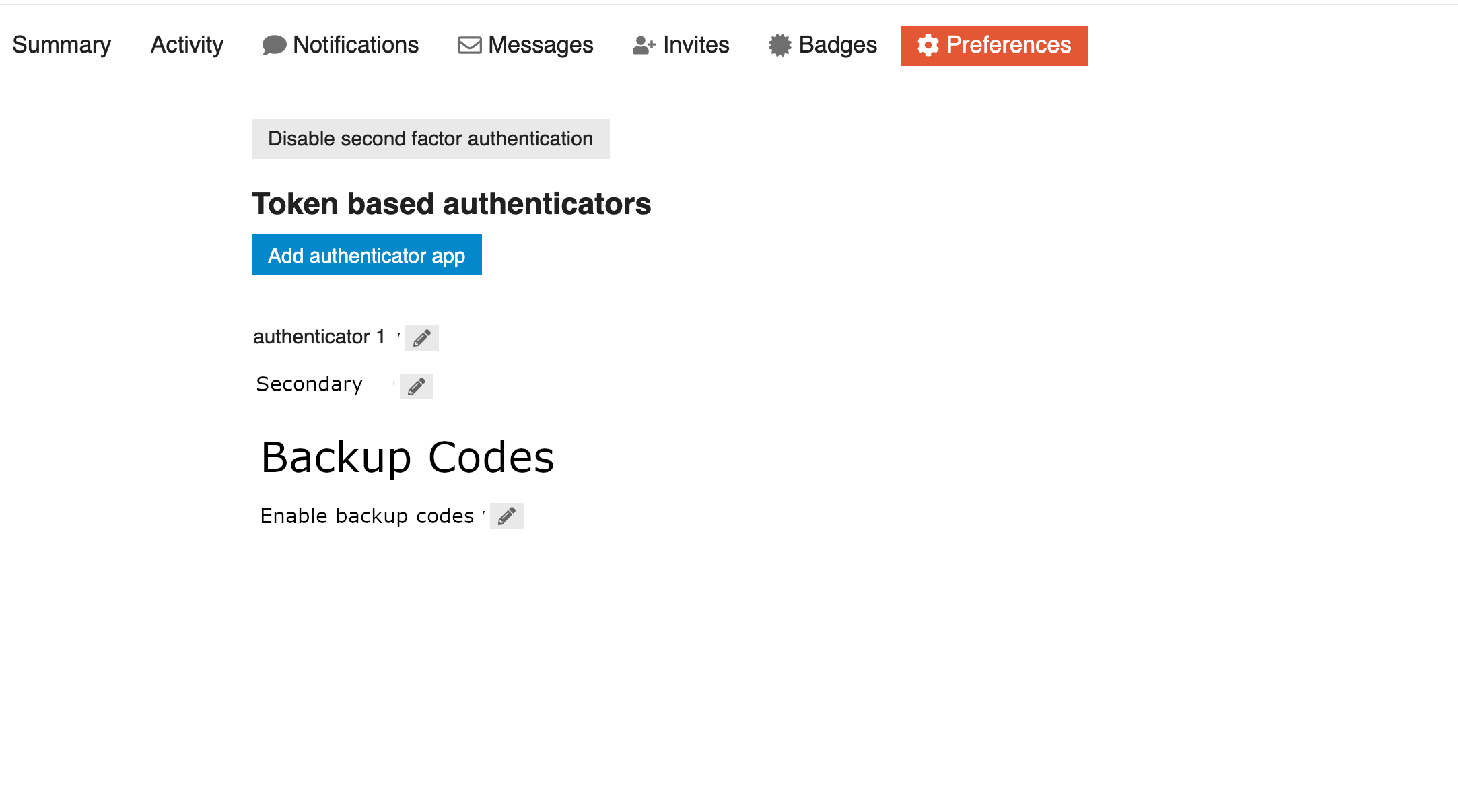

The resulting landing page (at /preferences/second-factor, after password confirmation) would look something like this (apologies for the ms paint work):
Adding a new authenticator app would deliver a similar modal with the same registration we’ve had before:
Other notes:
No other implementations I’ve seen ask for a confirmation before disabling the key, and I suggest we allow a signed in user to be able to remove keys at will with no additional confirmation.
Editing an existing key would allow a user to name the key, so a user can manage+delete keys semantically.
Disabling second factor will delete all a user’s tokens.
The work here would also make room for other types of second factors, such as managing web authn support. Yubico’s demo page has a pretty nice example of a page showing multiple types of tokens, and I suggest we adopt a similar stance on managing a user’s factors to help us get going in that direction.

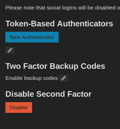

This feature has been merged now! :mango: I’m hoping this will make it a little easier to manage second factor tokens.
https://github.com/discourse/discourse/commit/88ef5e55fe67bf526a92f9ca85faf5257c83b087
Looks like the gray button with the pencil is my current “legacy” TOTP, which doesn’t have a name because it predates it.
I think we should have a fallback name since everyone will be on this state at first (for people who enabled TOTP before today).
For example:
8 лайков
Готово — теперь будет отображаться то же имя по умолчанию, что и для новых аутентификаторов :hot_pepper:
