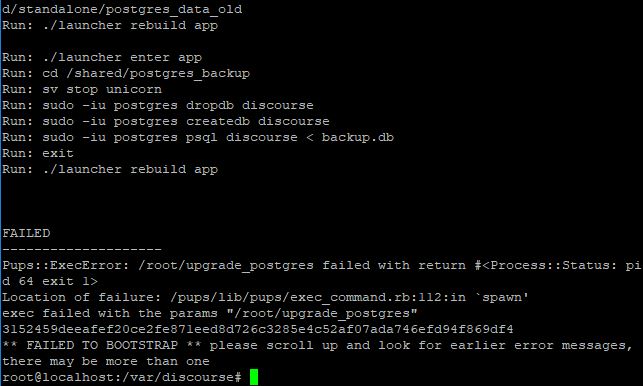

I’m still wanted to do some updates and got the message I should execute the following commands:
cd /var/discourse
git pull
./launcher rebuild app
I have done so, but I got a Error message and the forum is not available, now.
How to restart the service/ fix the problem?
Thanks in advance

This is the first time you’ve run an update in a long time?
It’s hard to tell with just a picture of part of the output.
I can’t quite tell what is happening. Did you type Run: before those commands? Or was that the output of ./launcher rebuild app.
You might be able to get the current version back up with
./launcher start app
If your forum being down is an emergency that you’d like to throw money at my contact info is in my profile.

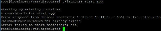

Yes I’ve never done a update before - The Systemw as set up in April 2018.
I’ve tried to execute the commands: ./launcher rebuild app . and ./launcher start app but without any success.
Do you have any other idea how to fix the problem?
I’ve still executed the commands which are described in the manual: Manually update Discourse and Docker image to latest and would like to start the session.
It seams the service is still running but nothing will be displayed if I would like to reach the forum.
I think I’ve found the reason why my forum crashed during the update.
If I add two hastags (##) before every git command in app.yaml file the forum is available.
One of the plugins is fault - how to uninstall it manually?

7
By hashing out the line before a rebuild you have effectively uninstalled it.
It’s a process of elimination as to which plugin is responsible though. Check #plugin to see if any are flagged as broken.
