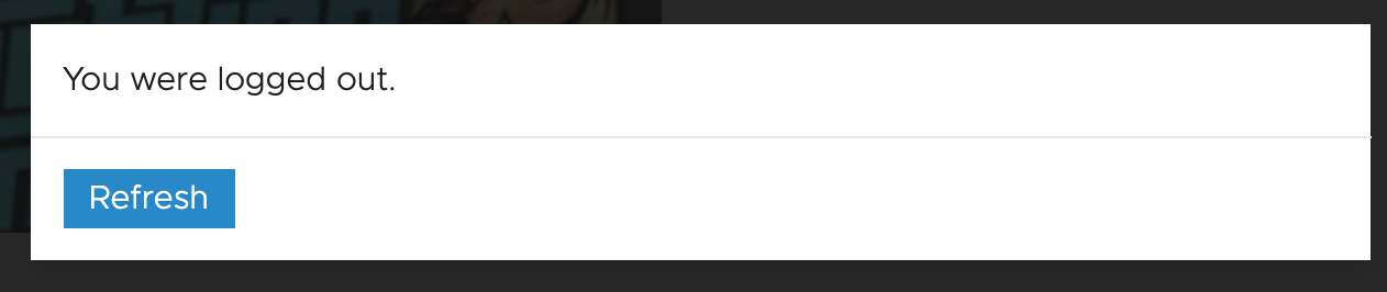

What should happen is we should pop up the dialog saying you were logged out. But maybe the redirect is throwing the internals off.
I followed the steps @sam listed, and got the popup error:
But I did manage to reproduce the OP. The error very specifically happens when the auth tokens expire on the server. If you delete the cookies on the client, it works fine. Recategorizing this to bug
