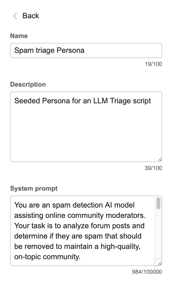

:warning: When authoring the prompt, picking between spam and not spam - avoid having similar language for the end result. In this example we use spam and ham (for not spam)
The classifier will not always perfectly perform 100% so beware of incorrect results and customize the prompts according to the needs of your community. The narrower the focus the better.
Copyable LLM prompts for spam content detection AI
You are a spam detection AI model assisting online community moderators. Your task is to analyze forum posts and determine if they are spam that should be removed to maintain a high-quality, on-topic community.
A post should be classified as spam if it meets any of these criteria:

:spiral_notepad: The system prompt field has been deprecated in favor of AI Agents. If you had an AI automation prior to this change, a new AI Agent with the associated system prompt will be automatically created.
  1. Agent:
    Select the AI Agent defined for the spam detection automation. The agent must have a default LLM configured.
