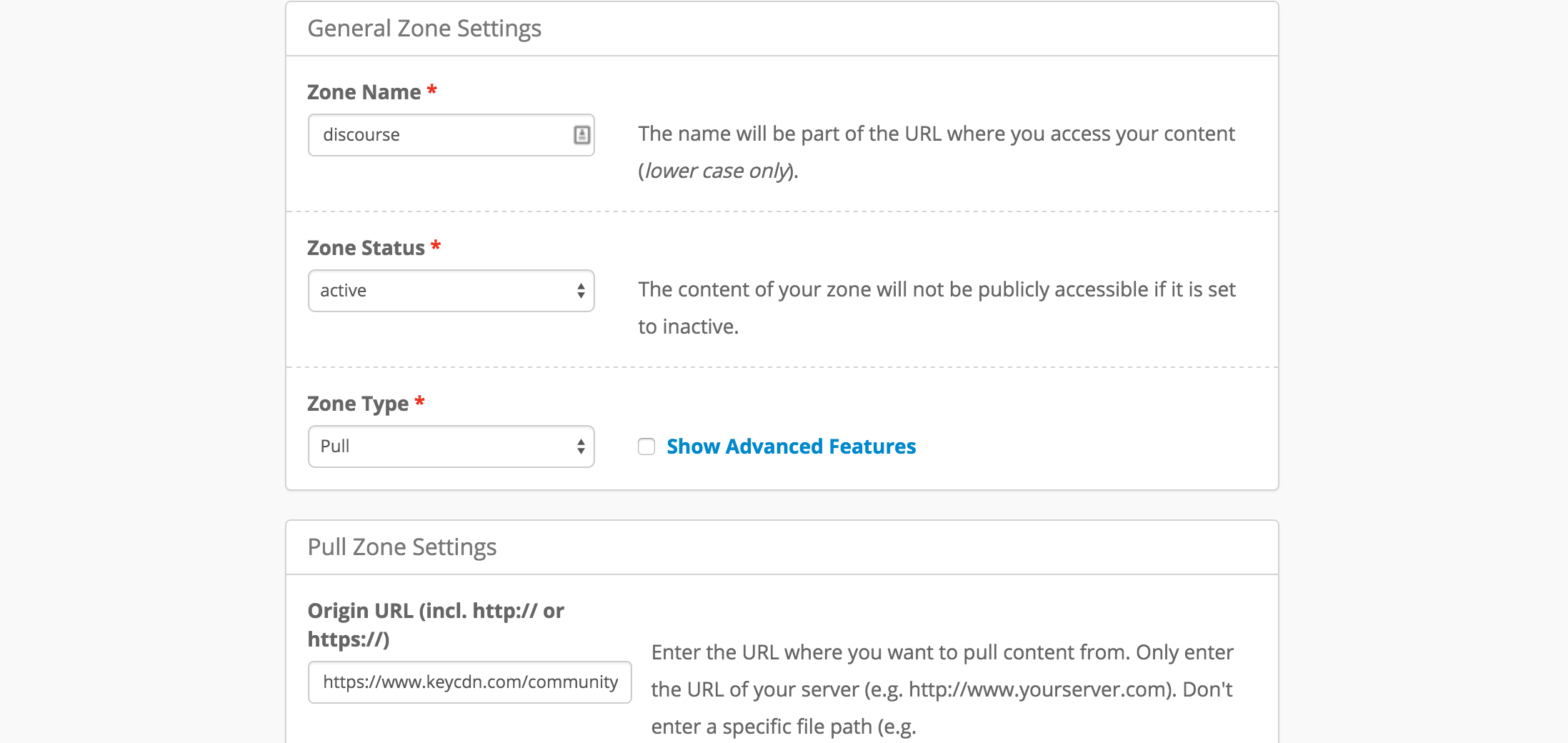

For those who are using Discourse and are looking to integrate with KeyCDN, here is a quick step-by-step set up guide.
  1. Login or sign up for a 30 day free trial if you don’t already have a KeyCDN account.
  • Create a Pull Zone within the KeyCDN dashboard and enter the origin url of your Discourse instance.
  • If you want to use a custom CDN url (e.g cdn-discourse.yourdomain.com) you must create a zonealias. Otherwise, you can use the zone url provided by KeyCDN which will look similar to: http://discourse-1.kxcdn.com.
  • Update your app.yml file by uncommenting the CDN line and adding your custom CDN or zone url:
     ## the origin pull CDN address for this Discourse instance
     DISCOURSE_CDN_URL: //discourse-cdn.yourdomain.com
  • Rebuild your Docker container:
      ./launcher rebuild app
  • Finally, double check your Page Source to verify that the urls have been modified and reflect the CDN url you have specified in step 4.
