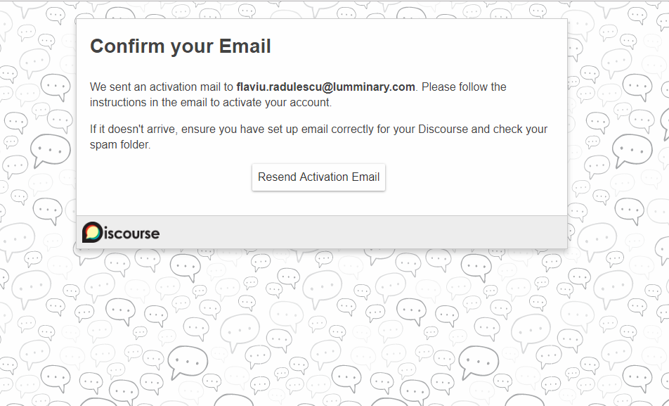

Dear Cameron,
There are some images which are not loading properly with discourse correctly installed in a subfolder on another server behind a reverse proxy. Please see the image bellow!
the problem is that the missing pictures have the wrong image path. instead of having thery are for the logo I could manage to change as these images are configurable from admin, but what about this emoji images which are not loading correctly?
so instead of being www.example.com/forum/img/img.png they are www.example.com/img/img.png
all the links, and everything else work as expected
Some other pictures are working, so I don’t suspect a miss configuration, but a bug.
Do you have any idea how I can resolve this?
Thank you

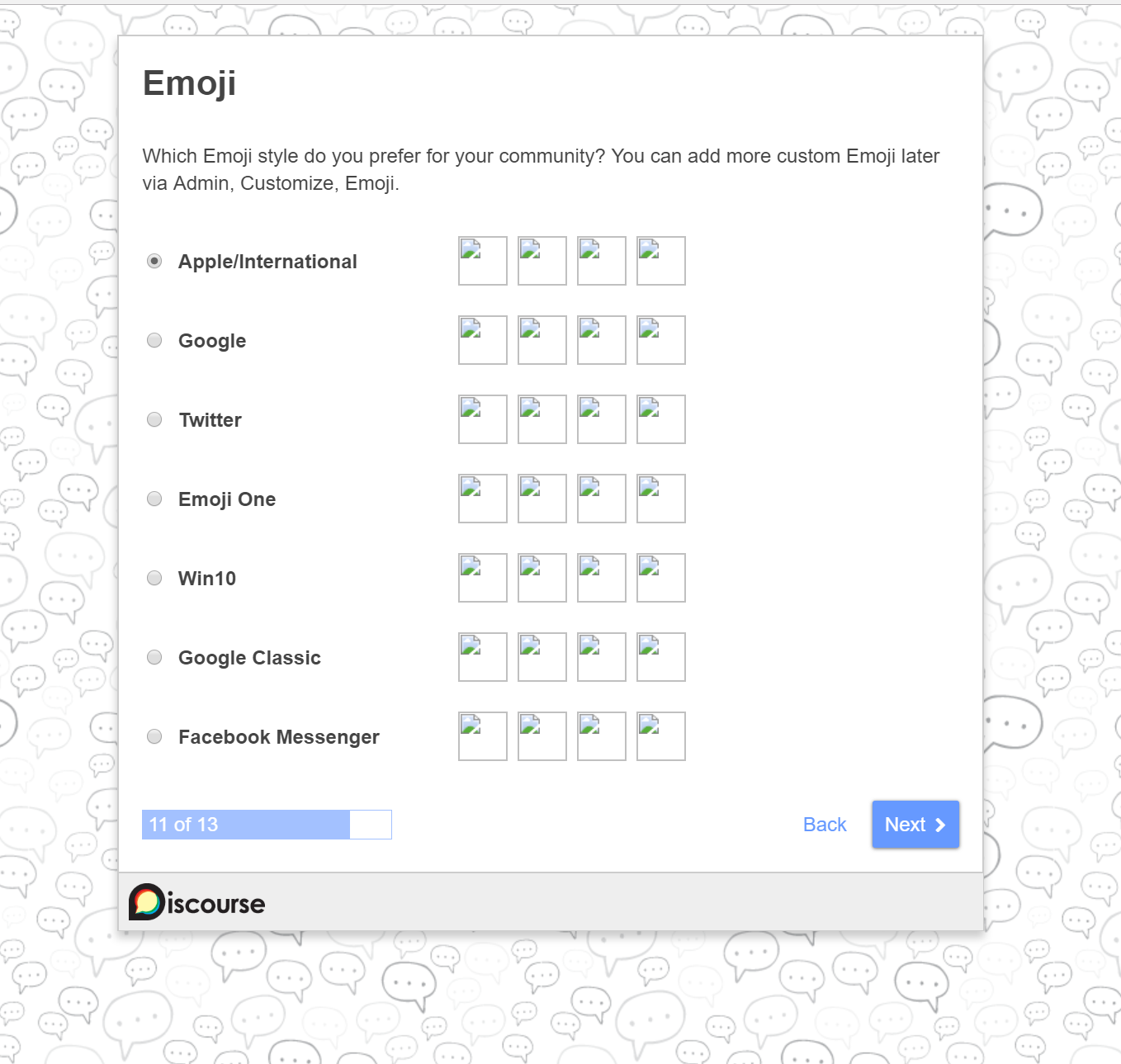

and here are two from the same instaltion which are not correct rendered
this one is from a recover password page
this one is from the initial registration process in which you can see above that other images are perfectly fine
and this is the html code for the above images which are not rendering
So, @sam, please tell me what I am doing wrong. I can give you the website URL if you want to see for yourself.

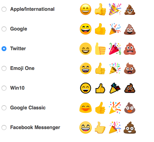

I’ve just gone through a subfolder setup on a brand new installation. Emoji icons in the wizard look fine.
So, if you follow the directions in the linked topic, it works. If you’ve setup things differently, then you’ll have to give a lot more detail about how you setup the reverse proxy. Otherwise everyone is just randomly guessing what the problem is.
7 „Gefällt mir“

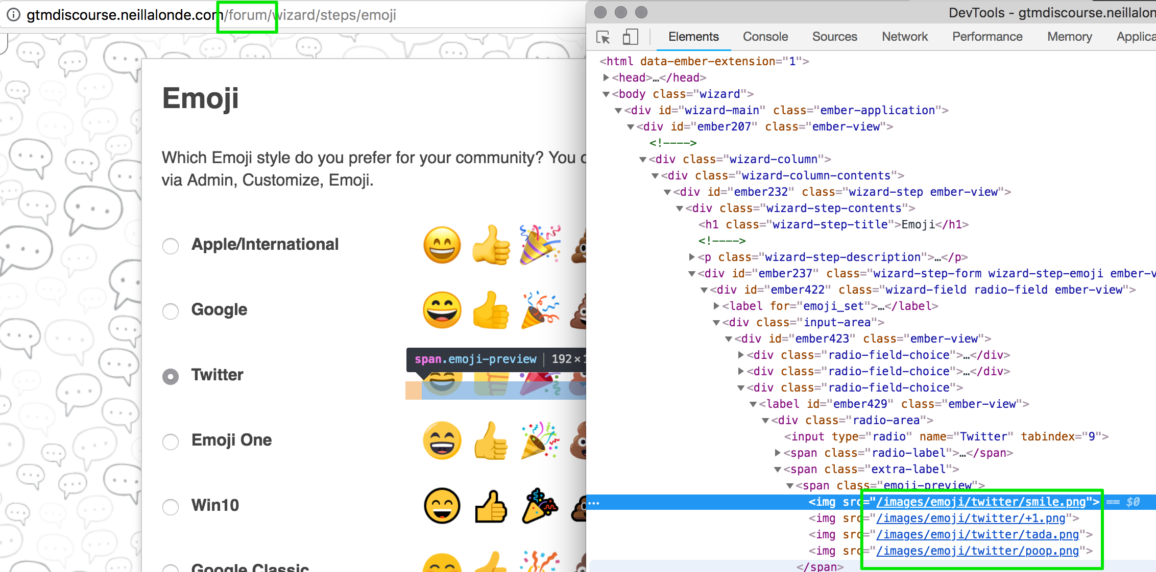

Hmm, works for me too but the image url’s are wrong. Looks like a bug:
4 „Gefällt mir“
