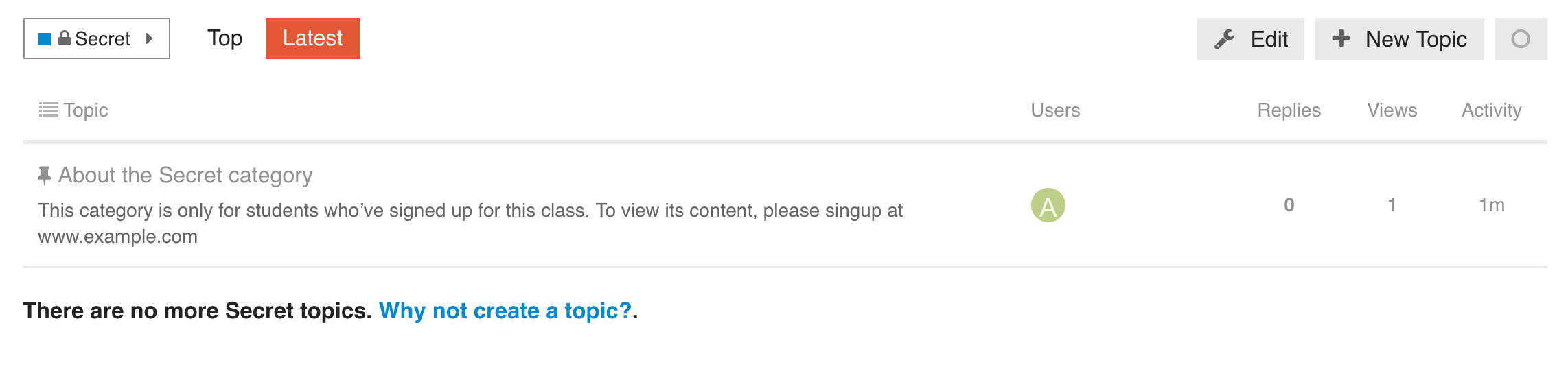

No additional functionality needed alternative: Can you create a topic in “Class A” and then pin it? Then visitors would see a topic and its excerpt instead of a blank page, for example:
Ah! I think this will do for now- thanks so much @awesomerobot!
