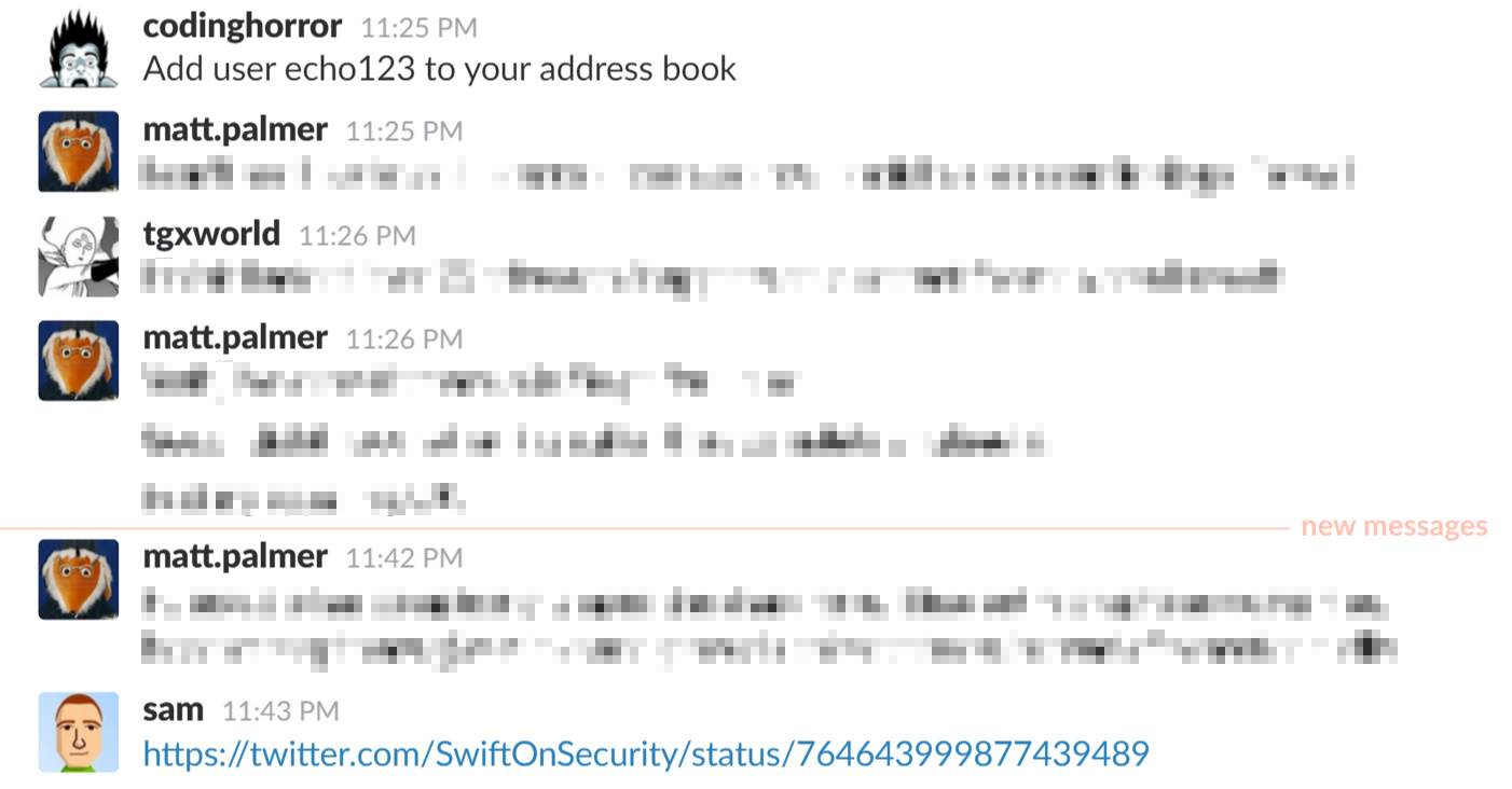

One thing that Slack does, is highlight the position of where you last read when you re-enter a conversation:

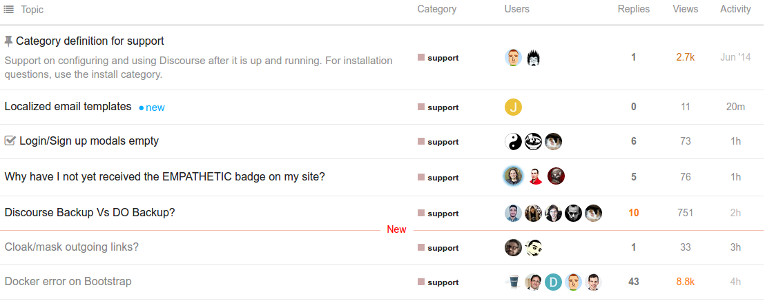

Ok @sam has this in, for preliminary testing. Where you see the simple dim red line in topic lists, that is when you were last here. Below is not updated since your last visit, above is updated since your last visit.

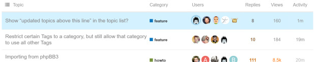

You don’t lose the position, every time you go back to a topic list, there is a blue fade that shows you which topic you are returning from.
Here is what I see when I go back to the topic list via the back button, from this topic:
(which fades to white)

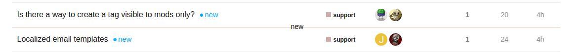

How well supported is something like .last-visit + tr::after?
Here’s a quick css test in chrome using the following:
.last-visit + tr::after {
    content: "new";
    position: absolute;
    left: 50%;
    margin-top: -10px;
    padding: 0 10px;

Using the adjacent sibling and the pseudo after looks good to me using Vivaldi.
I was afraid the margin-top would prove to be a “magic number” but it doesn’t have the problems I was having targeting last-visit
Looks like a winner to me !
That should actually do nicely. That is CSS2, I didn’t even think of using the +, @Falco, if you update your PR to use that for the CSS (since you have the data attribute for localization already in place) your PR should be good to go.
