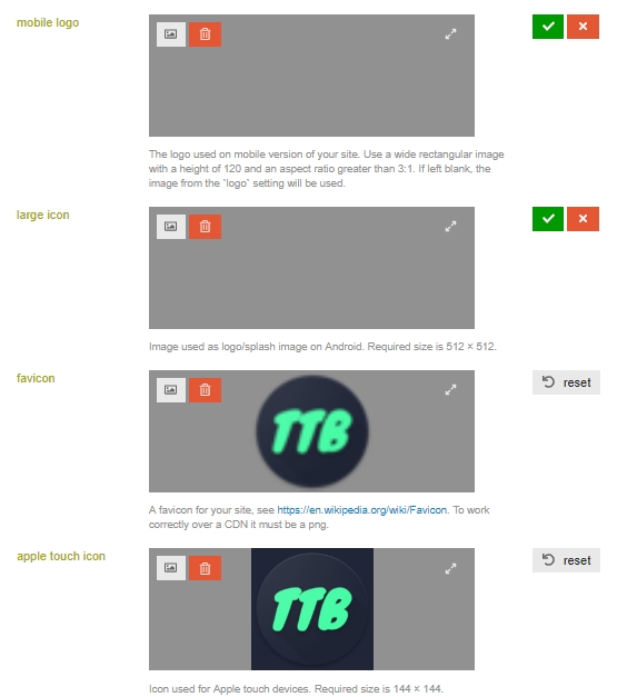

Hey guys,
Your work on discourse is great,
Just need small help,
After running discourse for few days I am having trouble with setting logo, as it breaks after few days (404 error in console),
All images in post working fine,
I can not upload again any logo,
Delete, reset and upload again doesn’t work,
at the same time Gravatar also stopped working,
I am not using cdn to serve images,

What happens if you try and re-upload a logo?
uploading 100% then blank,

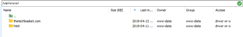

/var/www/discourse folder does not exist
Actual structure of discourse on my server is like this
/var/www/thetechbasket.com/discourse/
/var/discourse/
Is folder upload folder not mapped correctly? or permission issue?
Actually you can say right now upload functionality is totally broken,
on upload image path is created but it can not be accessed (404)
