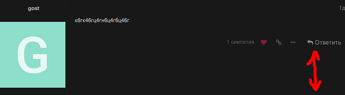

Because of the avatar, there were problems with indenting

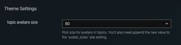

Ok so I tried this and it worked quite nicely. Here is what I did:
  1. created a theme and made it a component for my default theme
  2. defined an enum setting in the component theme and gave it some values to choose from
  3. added this piece of code in Common >> </head>:
<script type="text/discourse-plugin" version="0.4">
    api.changeWidgetSetting('post-avatar', 'size', Discourse.ThemeSettings.topic_avatars_size);
</script>
  1. and this piece in Common >> CSS
.topic-avatar {
    width: #{$topic_avatars_size}px; /* from theme settings */
And I got this (80px avatars):
Changed the setting to 100px, reloaded the page and got 100px avatars:

Also, how does it get the enum cause it would have to be based off the site setting (loosly) cause the site setting accounts for x2 sizes to allow for retina?
Currently the enum choices are purely set by the theme developer and they will need to remind the theme user i.e. admin to make sure the avatar sizes site setting has the selected value for the theme.
Though to be clear, that theme setting doesn’t have to be strictly an enum (it could work as an integer/string setting, theme users would have to manually type the value they want).
Yes I think that is a better call here for this particular setting, I would just use an int and maybe have a min / max defined by theme dev.
