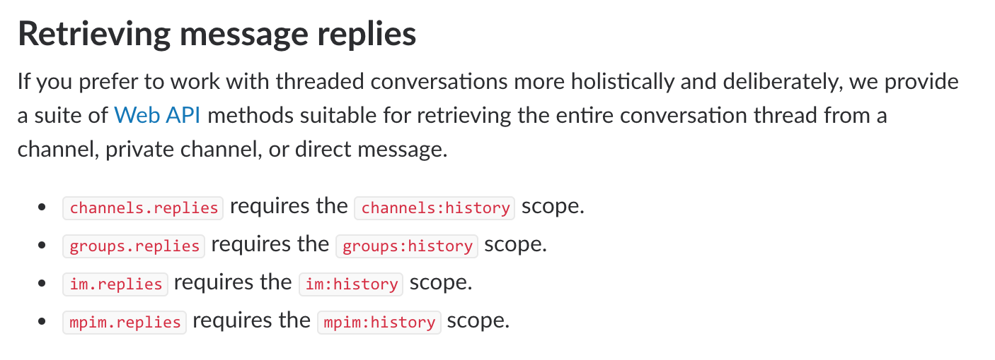

I just found this part of the Slack API which I missed before:
(Messaging | Slack Developer Docs)
So I think that means, given the start message, we can load its replies. It will require an HTTP request for every individual thread, which isn’t great, but since we are deferring the transcript processing anyway it might be ok.
Implementing that is achievable, but will be a fairly large amount of work.

I looked at the diff from the PR and thought perhaps it’d be necessary to add the conversations:history scope to the app on Slack, but I didn’t see that as an option. I tried adding the groups:history scope instead, but that did not seem to work.
Let me know if there’s anything else you’d like me to try for either of these issues. Thanks!
