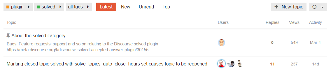

I wanted to know if there was a way to enable a sort feature for forums that have the solved plugin enabled to sort by Unsolved/Solved questions? The same way that we can sort on a Category by “Latest”, “New”, “Top”, “Unread” by clicking the link at the top.
I understand that this was sort of asked before, but I’m not sure exactly how to add a new sort “option” that has a link to reorganize the topics by those query params.
