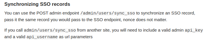

I saw the following from Setup DiscourseConnect - Official Single-Sign-On for Discourse (sso), but I’m thinking this is mostly if you want to sync without having a user login at all, but you can also sync while the user is logging in. Or? Hmmm…
