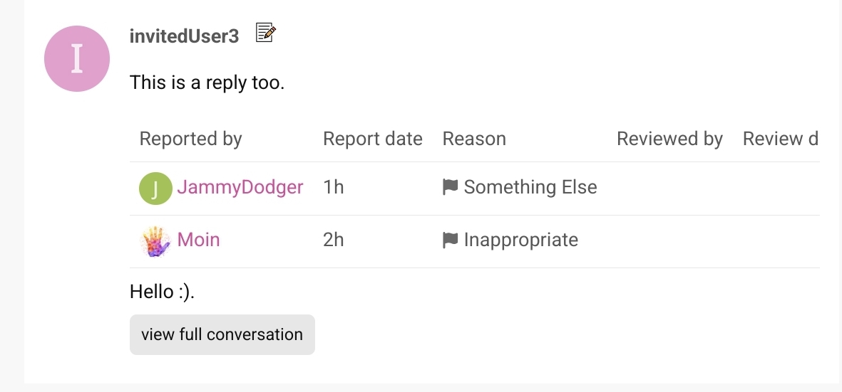

Continuing my wonderful Discourse journey (for context only been using it for 6 months now), I want to check and confirm something relevant to this topic.
I tested this now with something that had been flagged as Inappropriate.
Obviously, Inappropriate does not open the flag for conversation but Something Else does.
We then have 2 flags on the same post: if I then accept the flag and, say, delete the post the system then records both flags as having been acted upon.
Is this correct?
Are there any side-effects or other unintended consequences to having 2 flags on the same post?
Having two flags (or even more) on the same post is quite normal. :+1: Generally they come from different community members reporting issues with the same post.
I don’t believe a ‘something else’ flag counts towards auto-hiding the post, so I don’t think they’ll be any adverse effects from adding a ‘staff discussion’ one.
