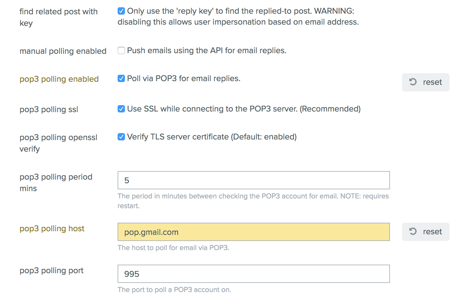

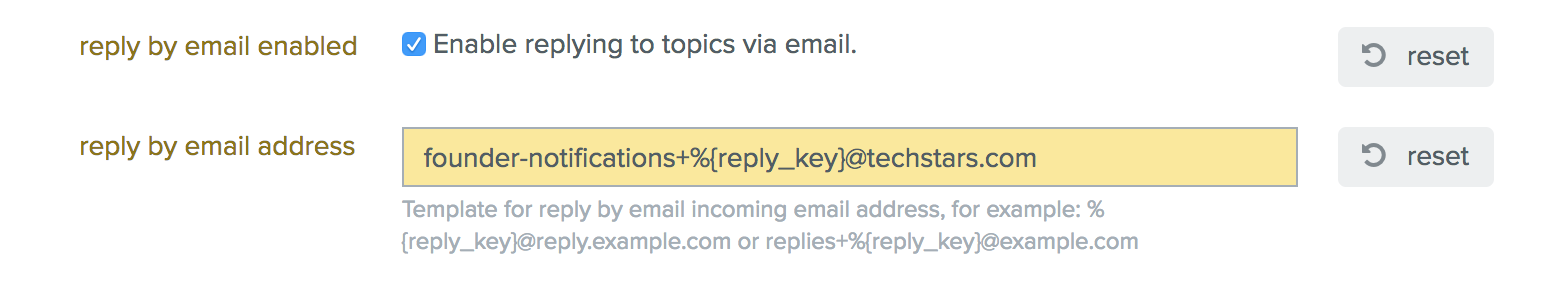

We use the standard reply-by-email settings:
But when I replied to a recent PM, I got an error from that reply-by-email address:
We run it on DigitalOcean use SendGrid for email, and have an incoming email address set up on our Google Apps suite. (I’m not sure what else would be helpful on the setup side)

As far as I’m aware, we haven’t had any queries from any of our hosted customers about problems like this, so the problem is less likely to be in Discourse proper, and more in how you’re getting email into Discourse. If you’re both using gmail/gapps via POP, perhaps they’re doing something funky?
That’s good information - thanks, Matt.
We haven’t changed our settings in ages - still using pop.gmail.com with SSL on port 995. Any chance there’s a new best practice for this?
I’m wondering if it’s still just @JoelZaslofsky and me having problems with this, or if others are seeing this, too?
Indeed. We haven’t used POP3 polling on hosted sites for… well, since about three months before this guide was written.
That explains it! We set up all our infrastructure about a year before that guide came out. :slight_smile: Thanks for the link.
