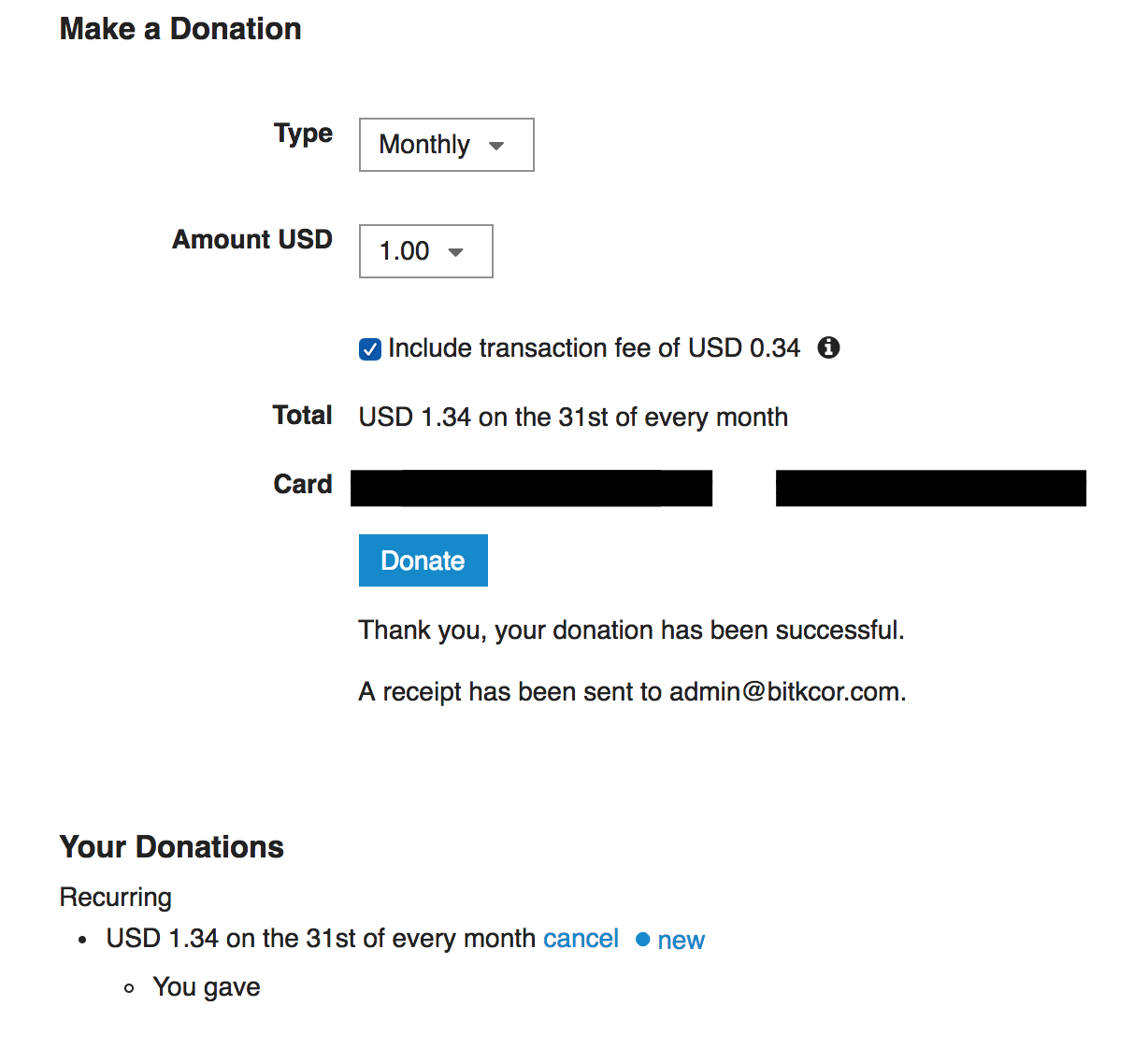

I add the plugin to my forum, it works perfectly! Thanks!
But two things are not ok :

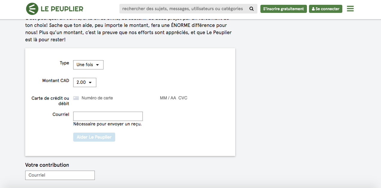

  1. This a french forum so I had to translate it and some text are impossible to translate. Is it possible to add these texts in the admin tab?
When it is successful :
Successful

For non-login, the plugin ask their email for the receipt. Can I have the option to remove it?
