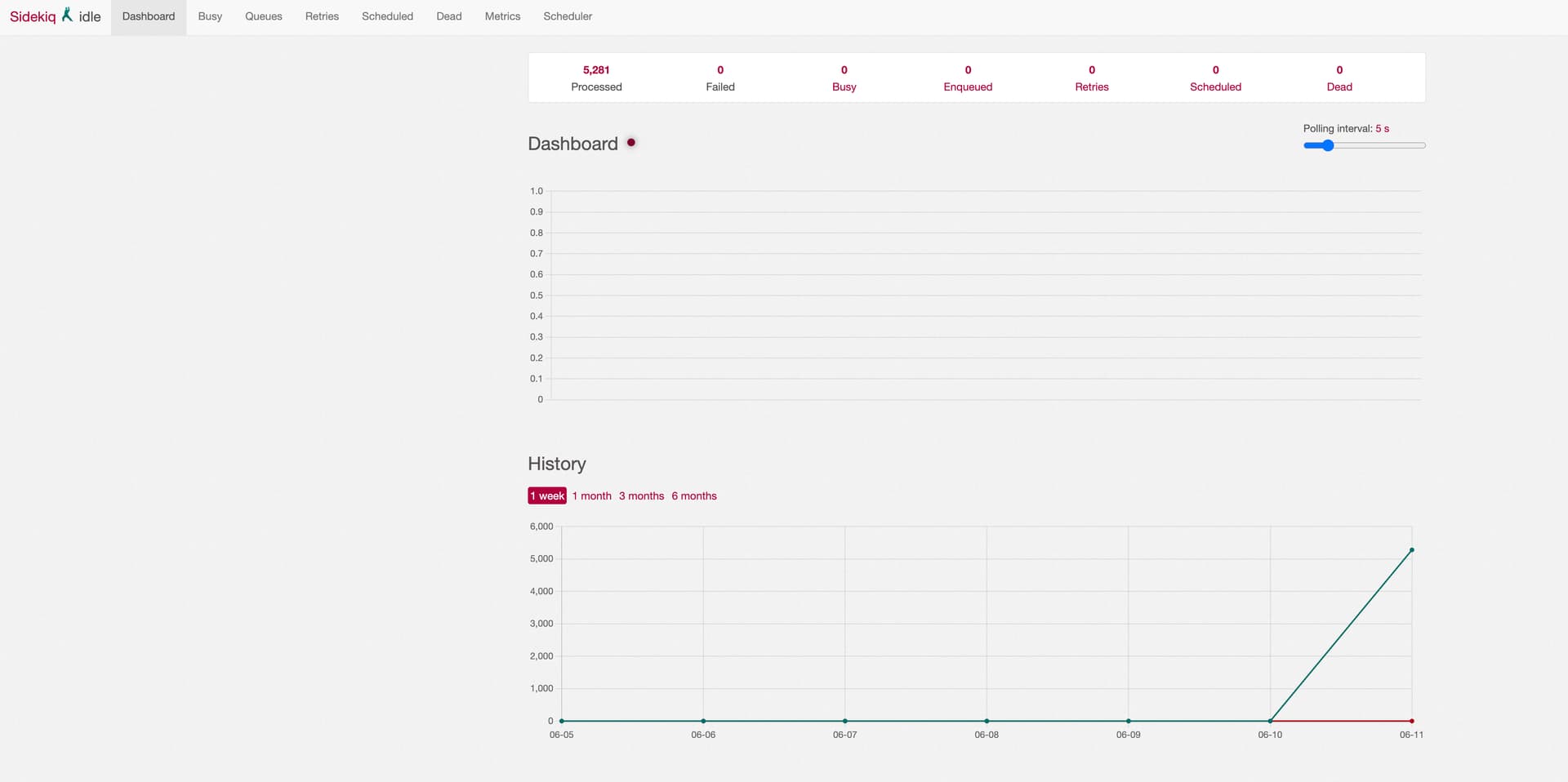

Suddenly, the forum that was “restored” online, all the post vanished, leaving just a couple of topics alive.
Since the log says “76198 posts were flagged for a rebake”, I thought it was just that now they have to be rebaked, so I went to Sidekiq but there is nothing pending to process :frowning:
Update:
Logged into the rails console, and apparently the are only 10 posts, not all the ones to be imported :thinking:
