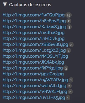

Hi!
Since the last update I have seen something that does not work well. Any content inside a Summary is not displayed (image, youtube video, gif, mp4, etc.), only the link is displayed. Before this did not happen, the Summary content was displayed correctly.
Any ideas?
Thanks!
