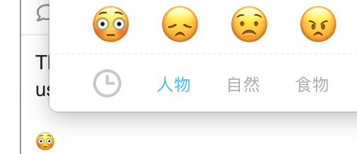

They can simply insert the actual Unicode emoji via their native OS emoji picker. I am afraid this might be a giant can of worms @zogstrip so I am not sure if we should take it on right now.

That’s good point. I use a IM which allows me to insert Emoji. As long as it’s shown as emoji in source view, users won’t notice the syntax at all.
