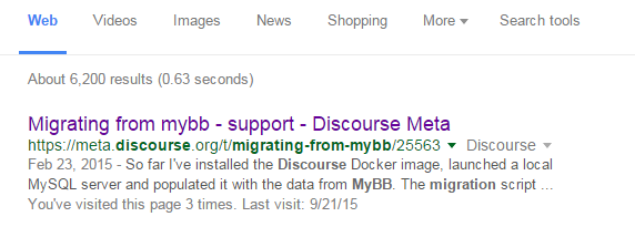

If someone lands on the top post of a topic from a web search…
…they might not easily realize that the topic is solved. Replicating in the topic title the checkmark from the category list would help.
12 лайков
I think this is a solid idea. I’m wondering if there’s a non-sucky way of indicating in the Google search results that the topic includes an answer, too. Sticking [SOLVED] on the topic title isn’t great, IMO, but I must say I do notice it in search results and tend to prefer them because

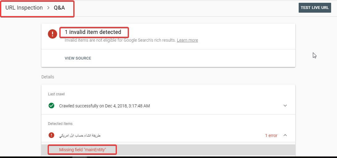

Hey @notriddle, this doesn’t seem to be working right now. Your example, as well as a random solved topic from Meta is getting an error in Google’s test.
Checking the search console of my website and found this issue. i know i have to fix it by some way but how ?

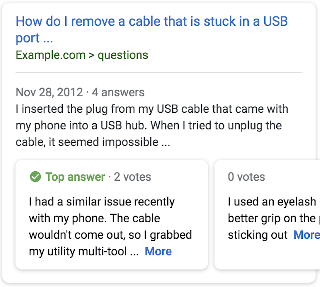

Yesterday (Dec, 3) Google Webmaster’s announce that they developed a new rich result type for question and answer sites. Search results for eligible Q&A pages display a preview of the top answers. This new presentation helps site owners reach the right users for their content and helps users get the relevant information about their questions faster.
When I read “expert forums” I think on all discourse sites :smiling_face_with_three_hearts:
Frequently, the information they’re looking for is on sites where users ask and answer each other’s questions. Popular social news sites, expert forums, and help and support message boards are all examples of this pattern.
\ 640x572
A screenshot of an example search result for a page titled “Why do touchscreens sometimes register a touch when …” with a preview of the top answers from the page.
Well… maybe we can develop something for this:

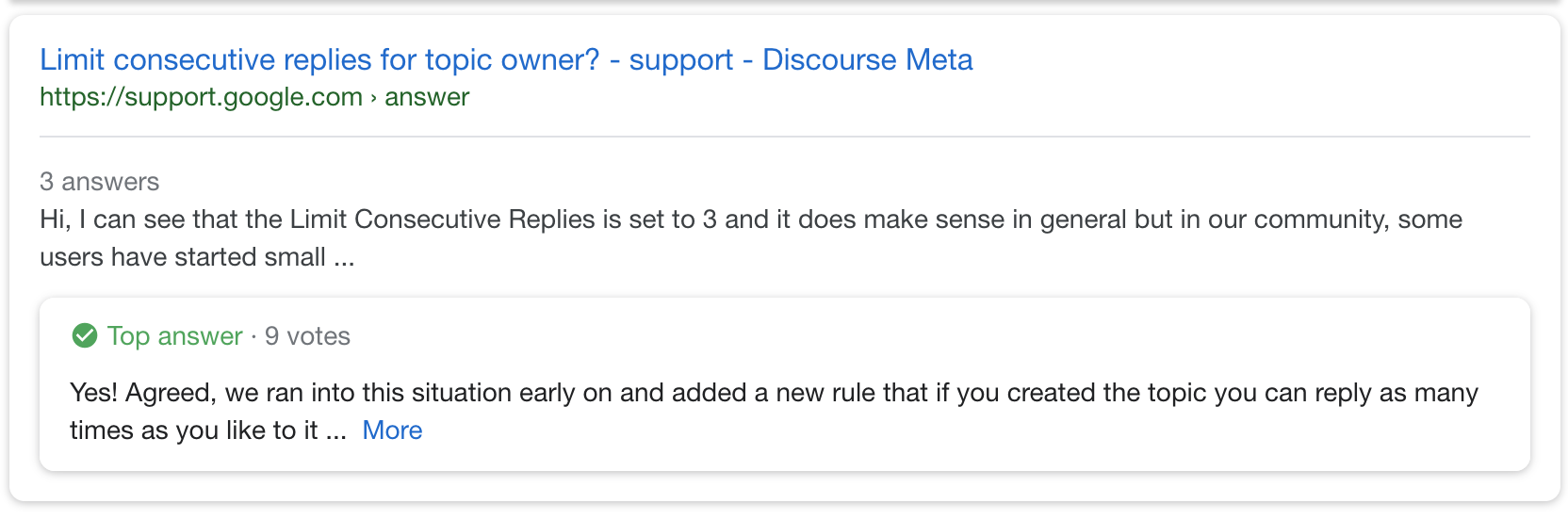

This was already implemented in the discourse-solved plugin (PR by @notriddle). If you view this topic as googlebot, you will find this in the head:
<script type="application/ld+json">
  "@context": "http:\/\/schema.org",
  "@graph": [
      "@type": "QAPage",
      "name": "Limit consecutive replies for topic owner?"
      "@type": "Question",
      "name": "Limit consecutive replies for topic owner?",
      "text": "Hi, \nI can see that the Limit Consecutive Replies is set to 3 and it does make sense in general but in our community, some users have started small personal \u201cBlogs\u201d in our Book o Remembrance.  the creator is generally speaking the only one posting.  These users are now  limited to 3 posts \nIs this  &hellip;",
      "upvoteCount": 2,
      "answerCount": 3,
      "dateCreated": "2018-12-03T22:44:18.304Z",
      "author": {
        "@type": "Person",
        "name": ""
      "acceptedAnswer": {
        "@type": "Answer",
        "text": "Yes! Agreed, we ran into this situation early on and added a new rule that \n\nif you created the topic\nyou can reply as many times as you like to it\n\n<a class=\"mention\" href=\"\/u\/nbianca\">@nbianca<\/a> made this change today or yesterday it is already in, so pull latest to get it.",
        "upvoteCount": 9,
        "dateCreated": "2018-12-04T02:36:30.988Z",
        "url": "https:\/\/meta.discourse.org\/t\/limit-consecutive-replies-for-topic-owner\/103405\/2",
        "author": {
          "@type": "Person",
          "name": "codinghorror"
</script>
And in google’s results tester:
It looks like we have some errors in the implementation though… google’s testing tool reports issues, and the escaping of backslashes looks all wrong.
