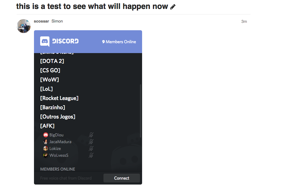

i installed the plugin and i try add my iframe of discord with command:
<iframe src="https://discordapp.com/widget?id=184421097603596288&theme=dark" width="350" height="500" allowtransparency="true" frameborder="0"></iframe>
but not happen, how to insert discordapp.com to whitelist?
You will need to cone the plugin to your own github repository and add something like this to the iframe-whitelist.js file:
(function() {
  Discourse.Markdown.whiteListIframe(/^(https?:)?\/\/www\.freesound\.org\/embed\/sound\/iframe\/.+/i);
  Discourse.Markdown.whiteListIframe(/^(https?:)?\/\/w\.soundcloud\.com\/player\/.+/i);
  Discourse.Markdown.whiteListIframe(/^(https?:)?\/\/graphics8\.nytimes\.com\/.+/i);
  Discourse.Markdown.whiteListIframe(/^(https?:)?\/\/www\.youtube\.com\/embed\/.+/i);
  // whitelist discordapp
  Discourse.Markdown.whiteListIframe(/^(https?:)?\/\/discordapp\.com\/.+/i);
You will then need to use your own repository as the source for the plugin.
3 إعجابات
Nice, work perfectly, its amazing! Thanks!
