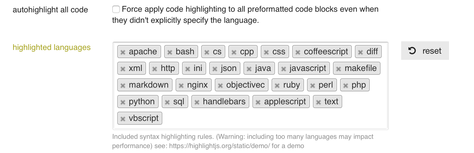

Is there some new setting I need to enable? My settings look like this:
It doesn’t seem to matter what language, bash, perl, applescript all do no highlighting.
