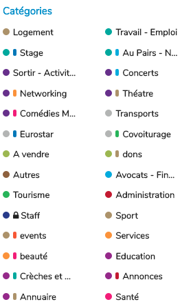

Hi all,
I hope you are well. Could you let me know how to only display catégories and not the sub-catégorie. Here is below what i have which look messy in my opinion.
Many thanks for your help,

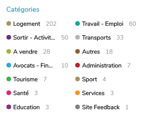

Yep great, it does the job perfectly.
Thanks a lot
