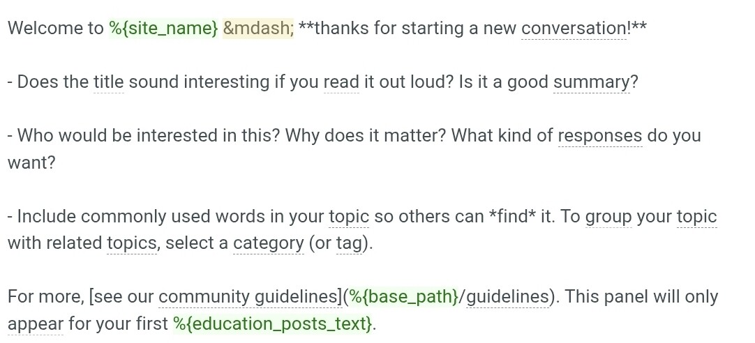

Is the message shown now the same?
I agree that the welcome part at the top was confusing after a year of participating. But I think even when the user has joined a while ago it still makes sense to tell them about choosing an interesting title.
Edit:
I just noticed the texts were changed 2 months ago.
Now they are much more alike, so it does not matter as much. But I think the detailed instructions were more interesting than the general “please read the guidelines”
Aren’t those separate counts needed for showing the right message? (Either education.new-topic or education.new-reply)

No I don’t think so. The translation key hasn’t changed as far as I can tell.
Only the count value has changed to combine both topic count and post count.
I think I’m being a :derp: :slight_smile:
So, the education.new-topic still shows up for your first two topics, and education.new-reply still shows up for your first two ‘non-op’ posts?
