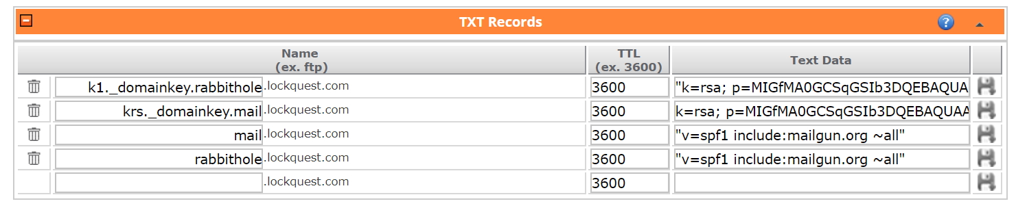

This is what my TXT records look like:

Just looking at that image again, i see i’ve got k1._domainkey.rabbithole.lockquest.com, and krs._domainkey.mail.lockquest. Should it be k1 or krs? There must be two different pages/guides that each use one of these versions, because i wouldn’t know enough to invent one! :slight_smile:
