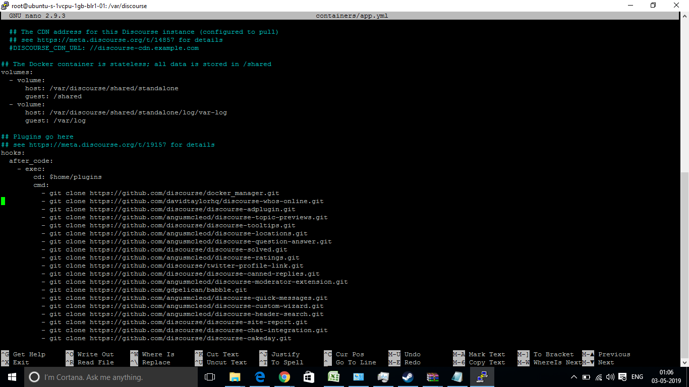

Do you have an non-standard plugins installed?
Only ones from github
Do they all start with https://github.com/discourse?
Yes absolutely! They are all from github.
Virtually every plugin in the world comes from github. They are not all maintained by discourse.org. What plugins do you have?
Remove all plugins and rebuild.
After that, start enabling just the ones you absolutely need, one by one.
Do you see all the plugins that do not start with https://github.com/discourse? You need to comment those out by putting a # at the beginning of the line.
Then rebuild and see that it works.
After that, you can uncomment them one at a time.
But you should probably do what @falco said instead.
