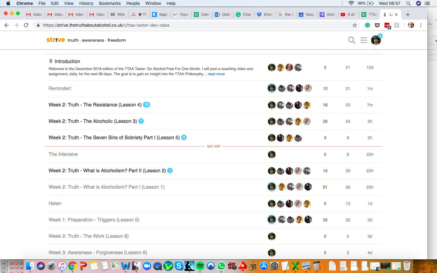

The attached screenshot is of a course I am running using Discourse. It’s spread over four weeks, and the students are asking for me to order the assignments chronologically. I can’t find a way to do this? Is it possible?

They are in order of most recent activity, though I think that they can be changed with a theme component.

Edit the category where the topics are, in the settings change " Topic List Sort By" to created.
If necessary, you can use the :wrench: button in the topic to change timestamps to re-order.
