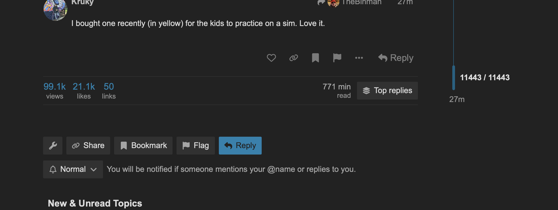

The link counter displayed at the bottom of a topic seems to stop at 50, even when there are over 1,000 links in the thread:
For reference:
On another topic, this one also says 50:
When there are 250+ links:
Does anyone know what might be causing this?

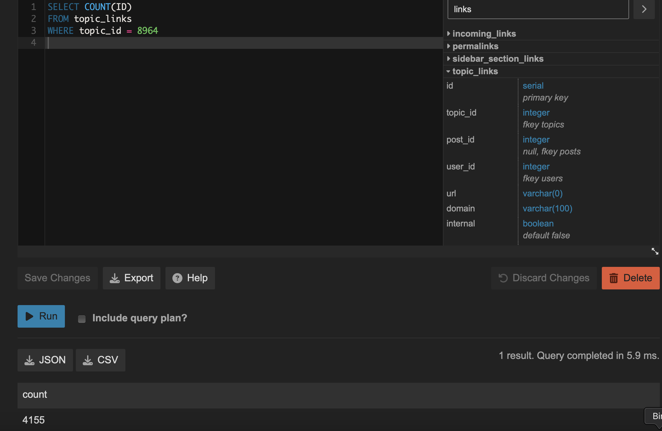

Without looking at the code, I think that number probably comes from topic_links, so something like
select * from topic_links where topic_id=1234
It does seem like a bug, though.

Interesting, hadn’t spotted that table.
If this helps, there are 4,155 links in this topic id yet it says 50x on the front end:

Sounds like a bug. Maybe share the link. Maybe look in the code.
Looks like it’s limited to 50 on purpose; I guess that it’s a complicated join and having it do hundreds or thousands would be a performance issue.

Yeah this lives between bug and ux.
On one hand it only impacts the UI of Discourse, on the other hand it is buggy to show a number that we know is not correct.
I think the simplest fix on our side is to select 51 and then show the text “50+” in the UI if we get 51.
It feels in the realm of pr-welcome, but I will leave @lindsey to triage and decide.
