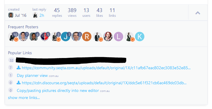

Topic "popular links" panel domain extraction doesn't handle country TLDs
It looks as though the domain extraction logic doesn’t understand country TLDs in domains – so it’s considering .com.au as a domain, rather than the more-appropriate seqta.com.au that the link uses.
This is, of course, a really tiny issue – at worst, it’s a bit confusing or meaningless. :slight_smile:
Our current logic only extracts the last two level in the domain name:

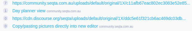

Hmm can you provide some examples of old and new here?
This is the new version where we show the full domain.
