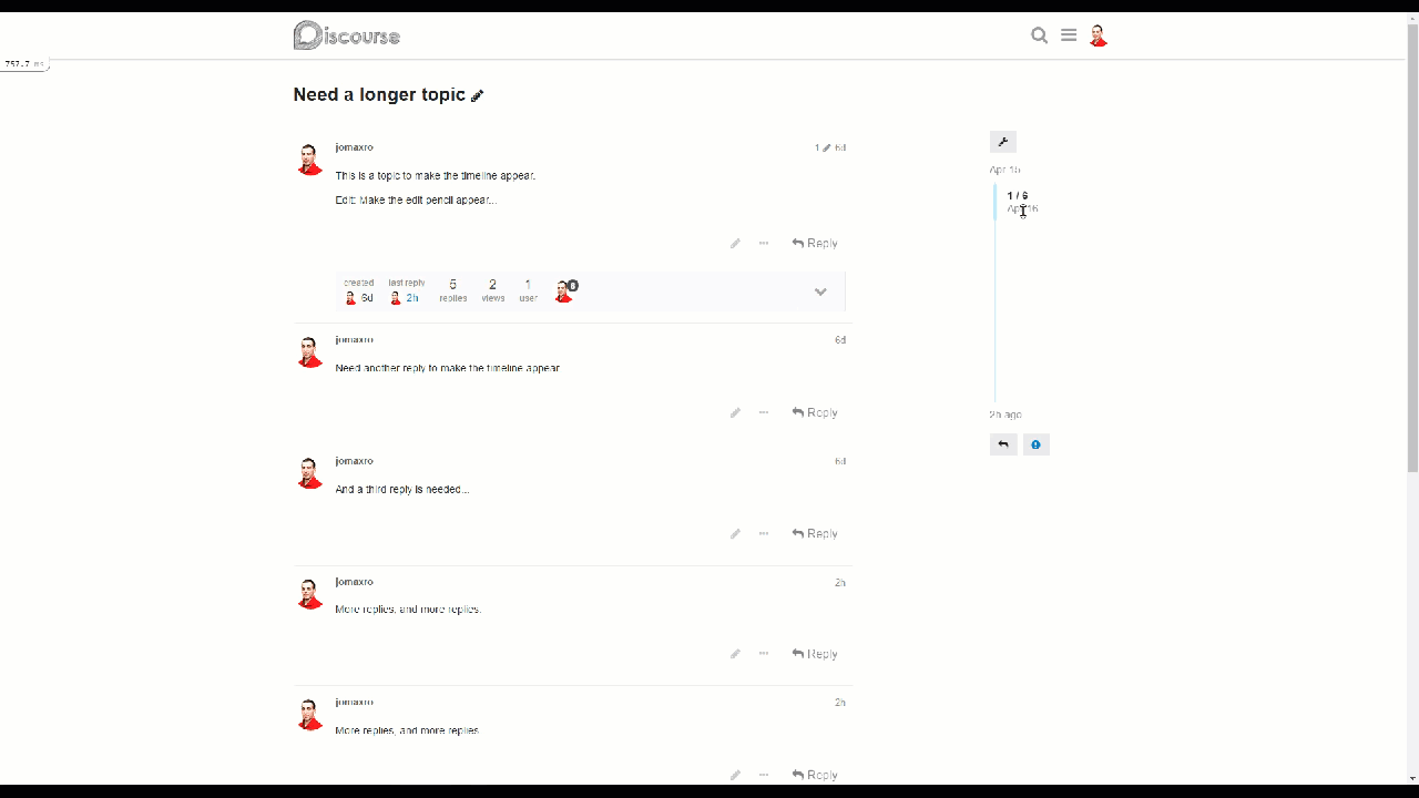

I started noticing on one of my sites (internal, so I can’t share a link) that the topic timeline was a bit wonky, and started playing around to try and figure out what was going on. Essentially when using the topic timeline to go to a recent post (like 5 or 6 out of 6) the posts would not scroll as expected, and the post that I scrolled to would not actually be visible. I couldn’t reproduce this on Meta or Stonehearth, nor in my development environment, so I started looking into what was different between the sites. I eventually realized that my site has suggested topics “disabled” (suggested topics = 0), while Meta, Stonehearth, and dev do not. After disabling suggested topics on dev I could reproduce the issue.

Videos of the issue:
Default - 5 suggested topics:
0 suggested topics:
20 suggested topics:

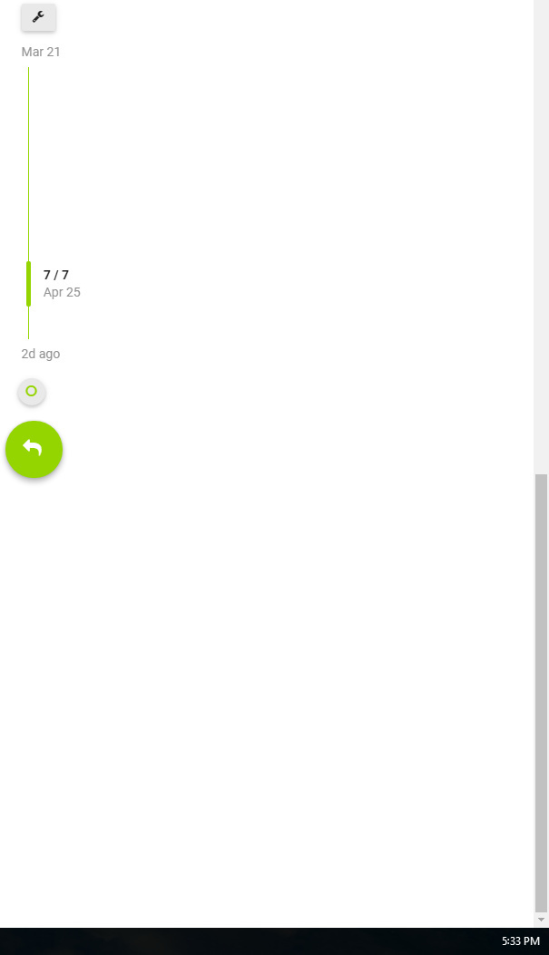

I hate to say this, but it’s “mostly” working. Just tested in the two topics I shared with you via PM. They both load correctly now (showing the last post) and using the timeline to go from a post to the last one work, but the timeline itself is very finicky.
Entering a fully read topic results in the browser being scrolled fully, but the timeline is not.
Also, moving via the timeline is incredibly jumpy. In topic 8022, moving the timeline to post 4 results in the timeline jumping to post 2 upon release. Post 3 also jumps to post 2. Post 5 jumps to post 6…etc.
