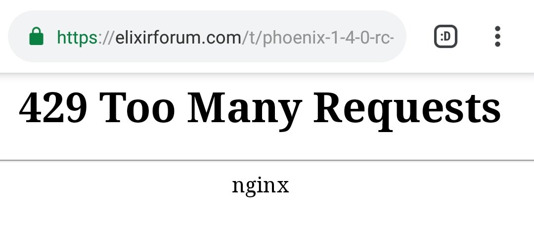

429(レートリミット)のトラブルシューティング
One of my forums went down yesterday, first with a blank page then displaying 429’s. Sam thinks it may be possible that my proxy is not configured correctly - anyone know what the best way is to ascertain whether IP addresses are being handed over correctly to Discourse?
