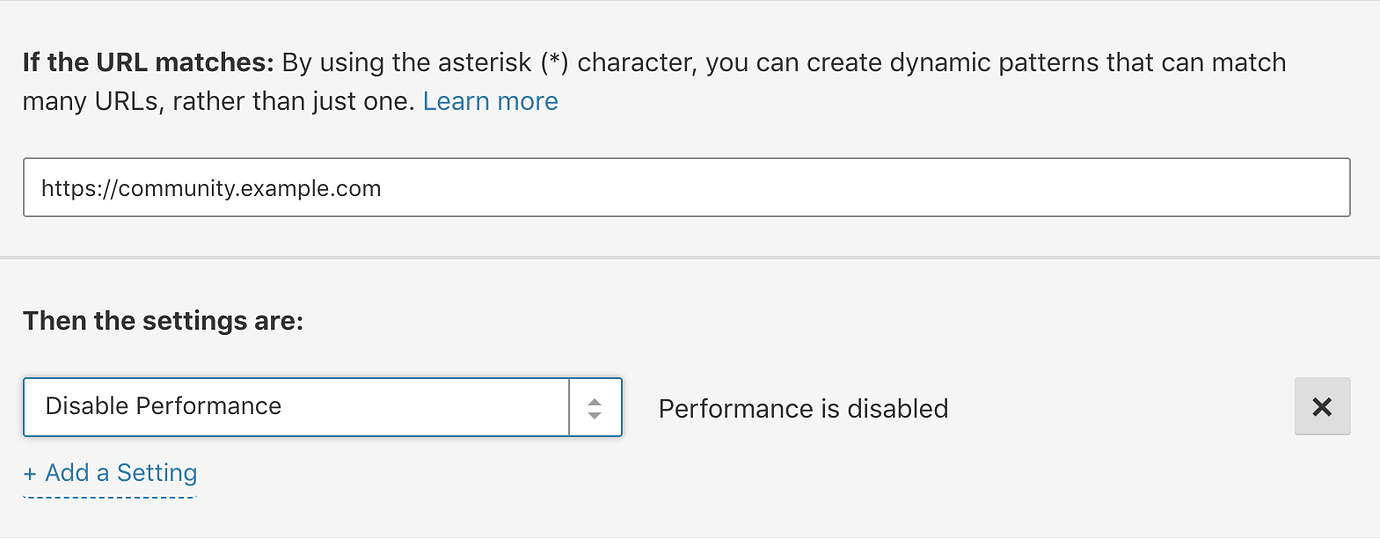

Note that certain CloudFlare features are incompatible with Discourse, you’re going to need to create the following page rule:

And once You’ve got cloudflare proxying everything and managing ssl, pretty much all that’s left is to create a page rule and disable performance.
