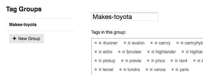

I think the mistake is the assumption that removing “crafting” has deleted it. The error “name has already been taken” is telling the truth. There was a problem where unused tags were not being shown anywhere, which is probably why you thought they were deleted. I fixed that today. So you can find it on your /tags page or navigate to /tags/crafting and delete it.
We don’t automatically delete tags because we allow you to pre-define them. For example you can setup your tag groups like so:
2 curtidas

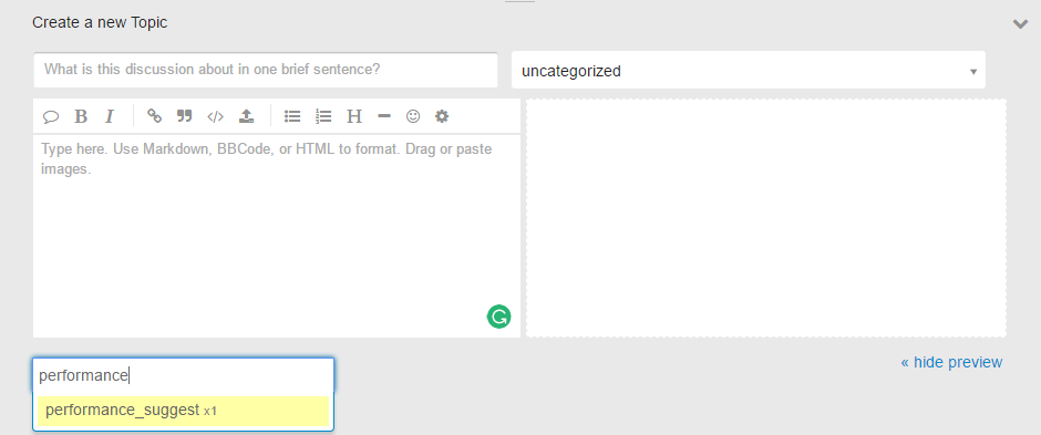

The issue is still occurring at Stonehearth right now, try to create a topic with the performance tag. It is not being allowed:
Once we get an update deployed I can go through /tags and delete all tags with no topics to solve this, but I don’t feel I should have to.
