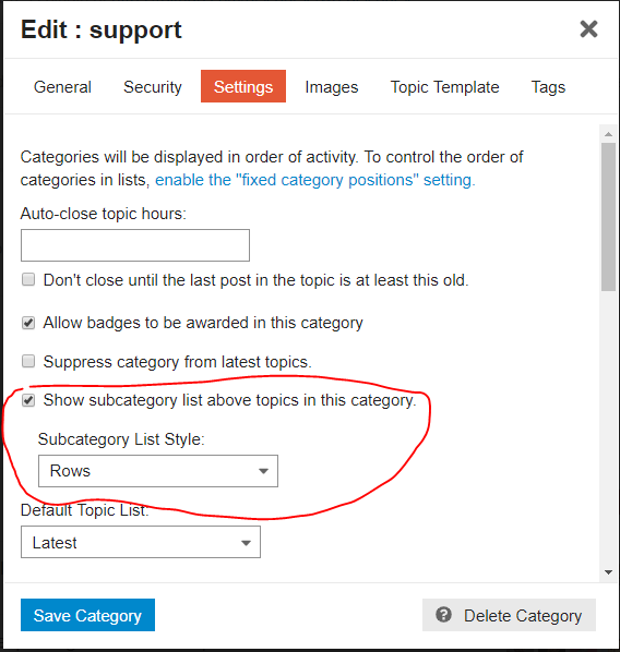

Enabling this setting doesn’t seem to enable the same layout one level down. I.e., when I click into a category, I only see the latest topics, not subcategories with featured topics. Is this something I would have to customize myself?
Correct, the above setting applies only to the main categories page. You need to configure the layout for each category, check out the settings tab within a category edit modal:
