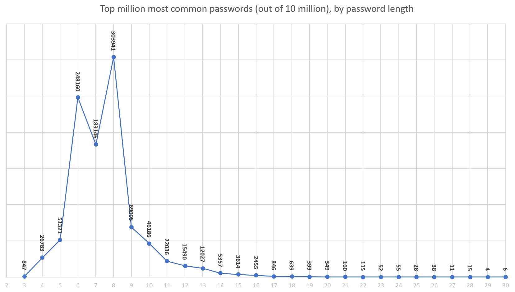

It is many many millions, all the common password lists merged together. The reason the list isn’t very big is because of this graph.. which was in the above blog posts.
I will leave understanding that, as an exercise for the reader..
Really, read those blog posts closely @schungx. You’re making me repeat myself over and over here for no good reason. All the info you need is there.
Well, that probably means that you have not been very clear about what you claim as 10 million.
What you really mean is:
  • Discourse checks against the 10,000 (as per setting) most common passwords that are >= 10 characters in length (default setting in Discourse)
  • The 9,990,000 passwords < 10 characters long are not checked because it is assumed that the minimum password length is 10.
  • It is caveat emptor if I set minimum password length < 10!
Sort of, you need to read the blog posts closely. Study them like a textbook. There are years of work behind those posts.
