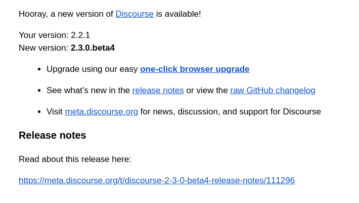

Hi all,
I have received below email asking me to upgrade.
I click on one-click browser upgrade using my Discourse admin account but then I get to this error page:
What am I doing wrong at this stage?
Thank you! :blush::+1:
